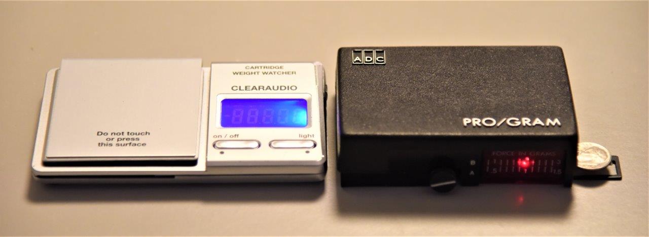

I don't have any experience with an Aro but I stopped trusting old mechanical balance scales years ago.
Even a fingerprint contamination between the balance points causes drag.
Maybe I take things too far. :smt101 :smt100

Really I should get one of those Rega scales, or maybe I should try to set stylus force by ear, although I'm sure that's a tedious task on an Aro.

As for scales ive got a digital one " Cheapo " but tested against a Clearaudio and the numbers were the same but not so posh. :smt005

These digital scales seem to hold their accuracy fairly well.
I bought one back in the 80s and bought a Clearaudio recently to double check and what do you know?
Both had the exact same reading...the Clearaudio went another decimal place though. :o :smt023
