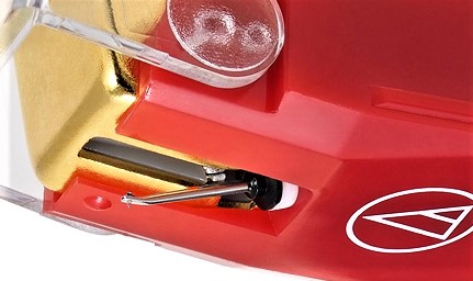

There are various methods of bonding the diamond to the cantilever, but from this photograph of a AT VM 740 ML,
I don't see any dark coloration and/or matter at the base of the diamond, so I concur with Coyote Jim as to the use of a cleaning brush to remove any debris from the stylus.
