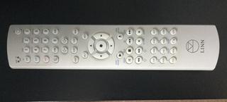

That doesn’t sound right to me. Just tried it using this remote but you may have the new remote...
Is this the remote?

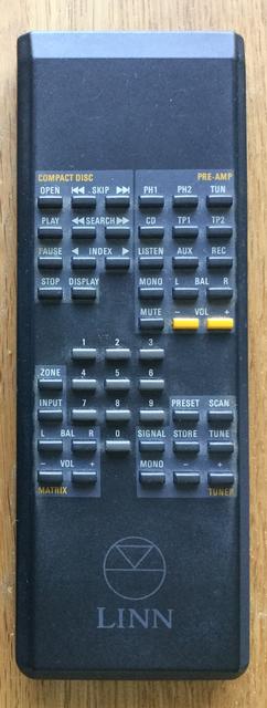

As I see it I was using my pre amp remote and not the one that came with the DS. It has a stop button where the DS remote only has a pause button and the ipad using Roon only has a pause symbol too. Using the pause on all three items stops the music so I can only presume this is done deliberately by Linn. Will have to use the new one and put the old one away. Thanks for high lighting things for me. By the way my old remote is very similar to your pic and the new one is not and is far leaner in the button department. Cheers

I even tried it on this old remote (using the CD buttons) and it worked so it must be the new remote.
